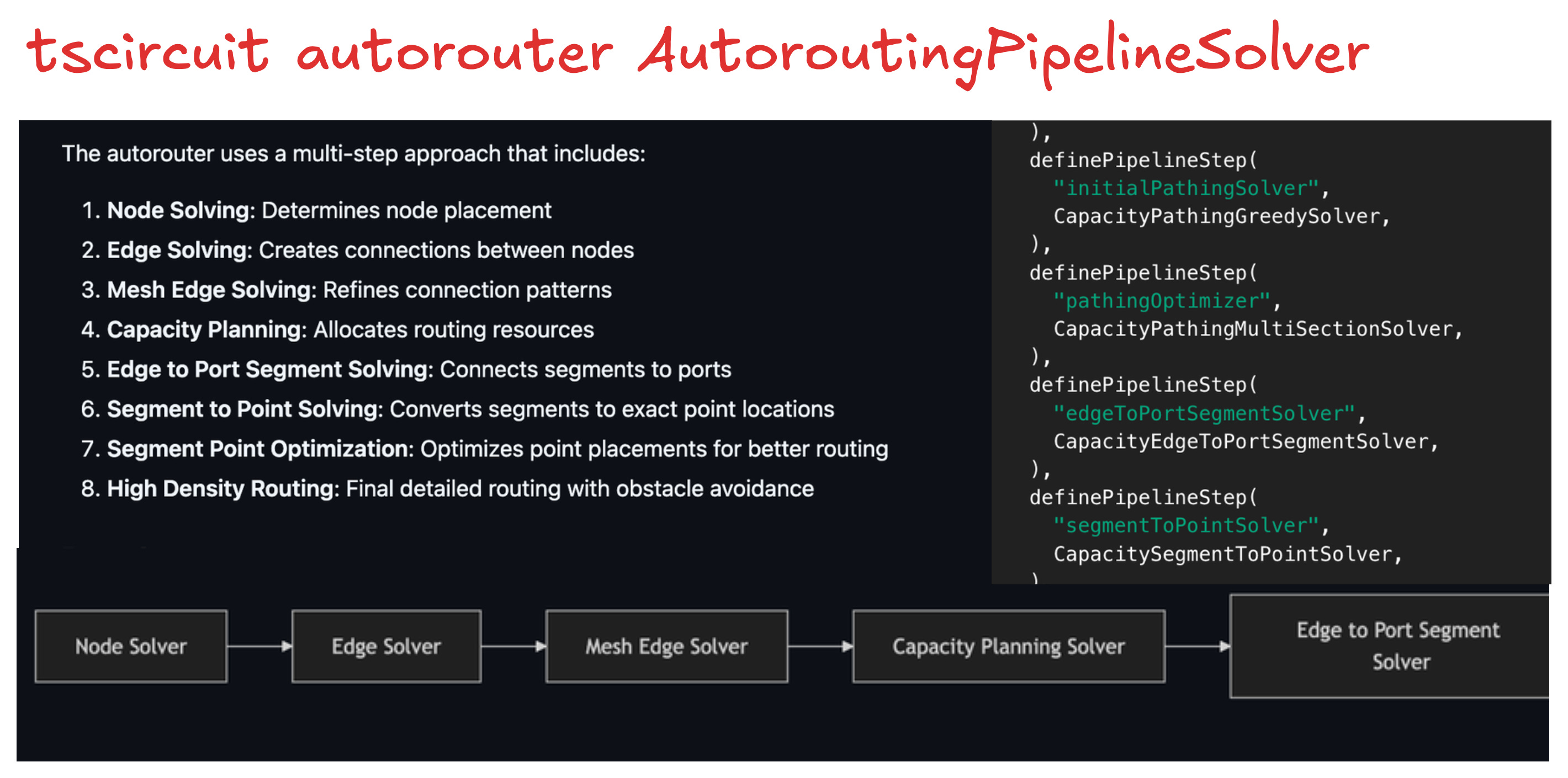

Pipeline - Always have a top-level Pipeline that moves your data through different sub-algorithms. EVERY COMPLEX ALGORITHM HAS MANY SUB-ALGORITHMS! It is a mistake to think of an algorithm has a single function or a single stage. Every obvious algorithm is already packaged or in a standard library, if there is any complexity to what you’re doing, you need to have a pipeline.

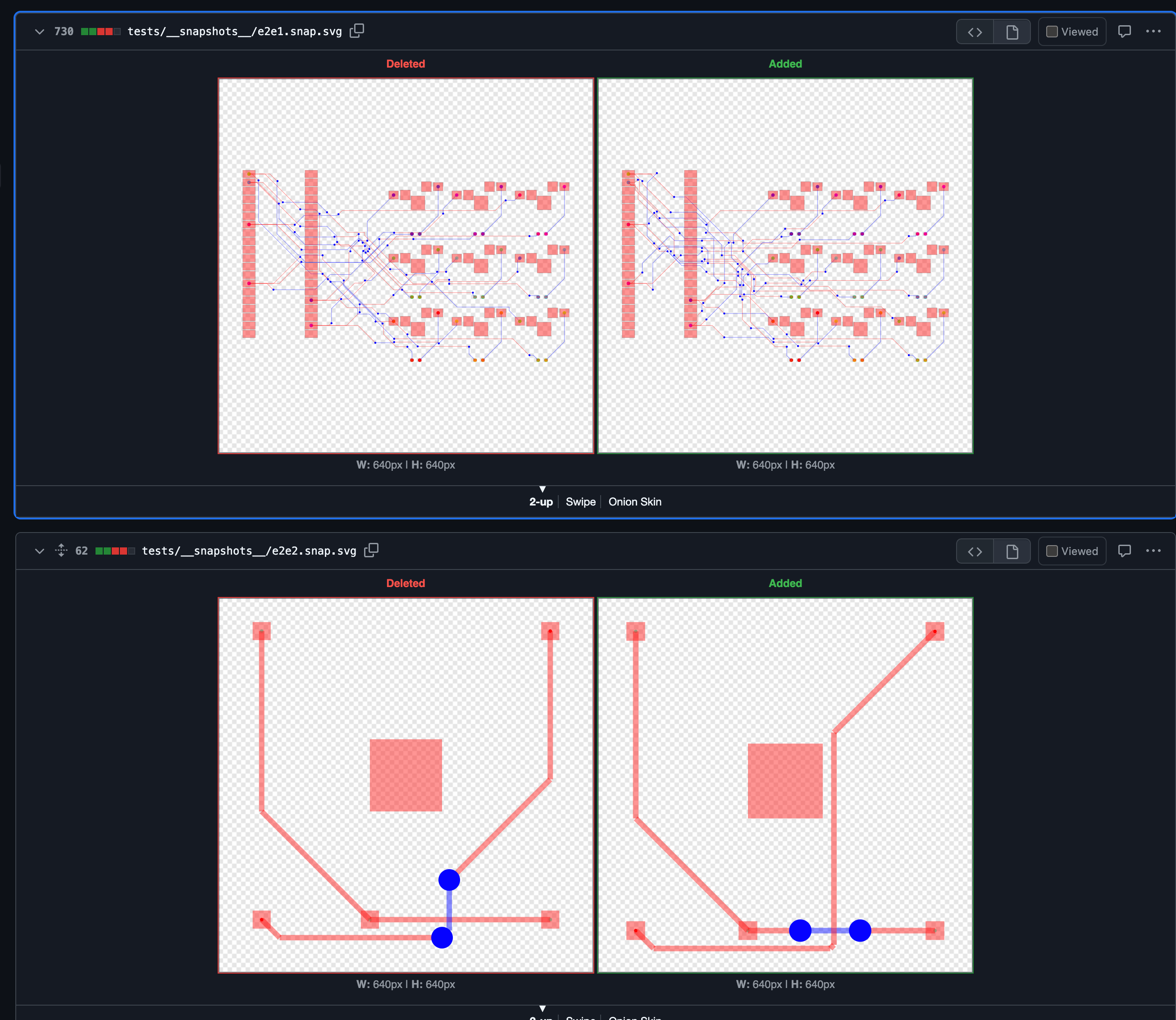

Snapshot - You must take snapshots of your algorithms output in a way that is understandable to humans. Humans generally forget/are bad at looking at numbers, so you should use Visual Snapshot Testing (SVG outputs) to allow humans to see the impact of changes in pull requests.

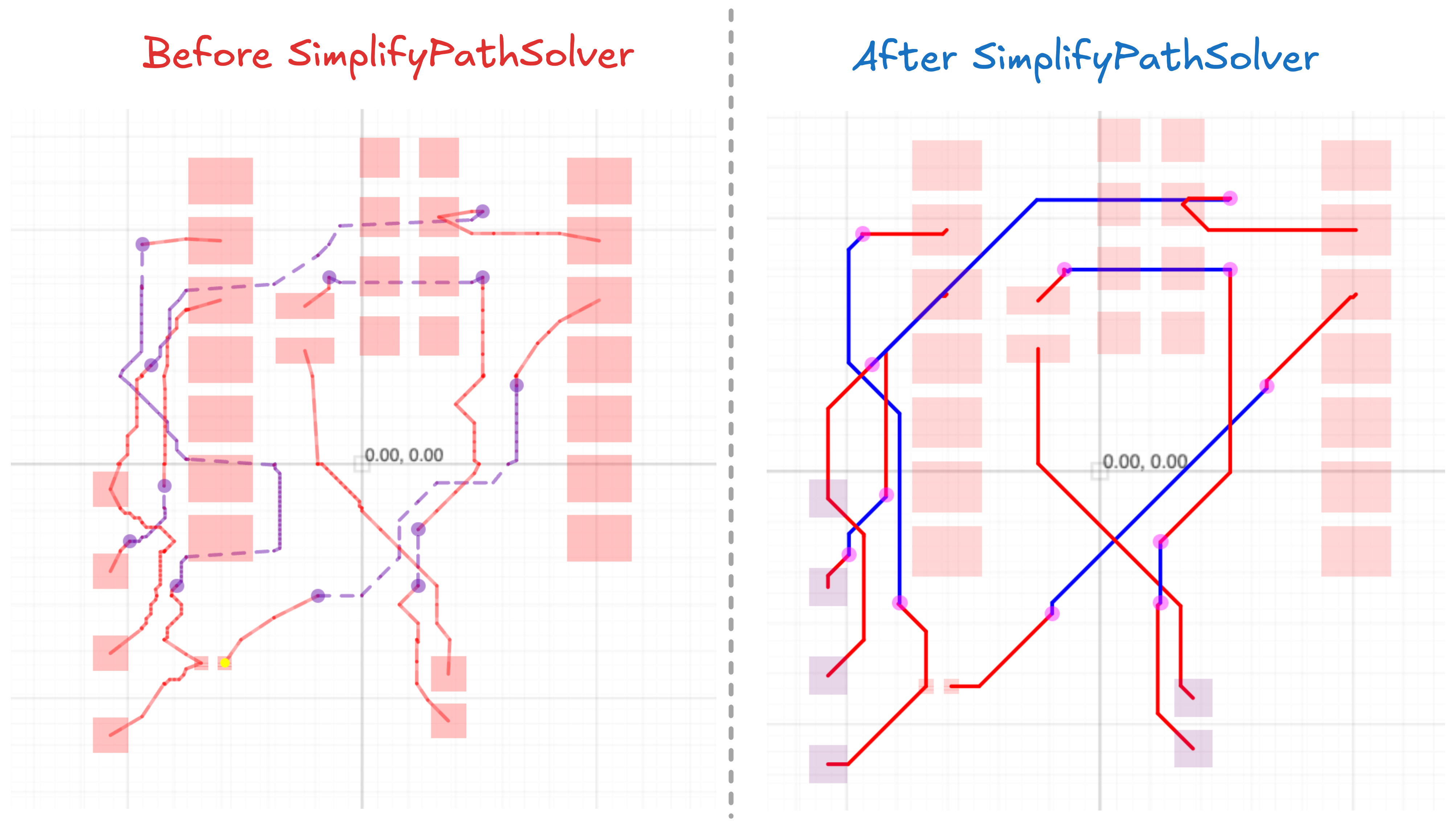

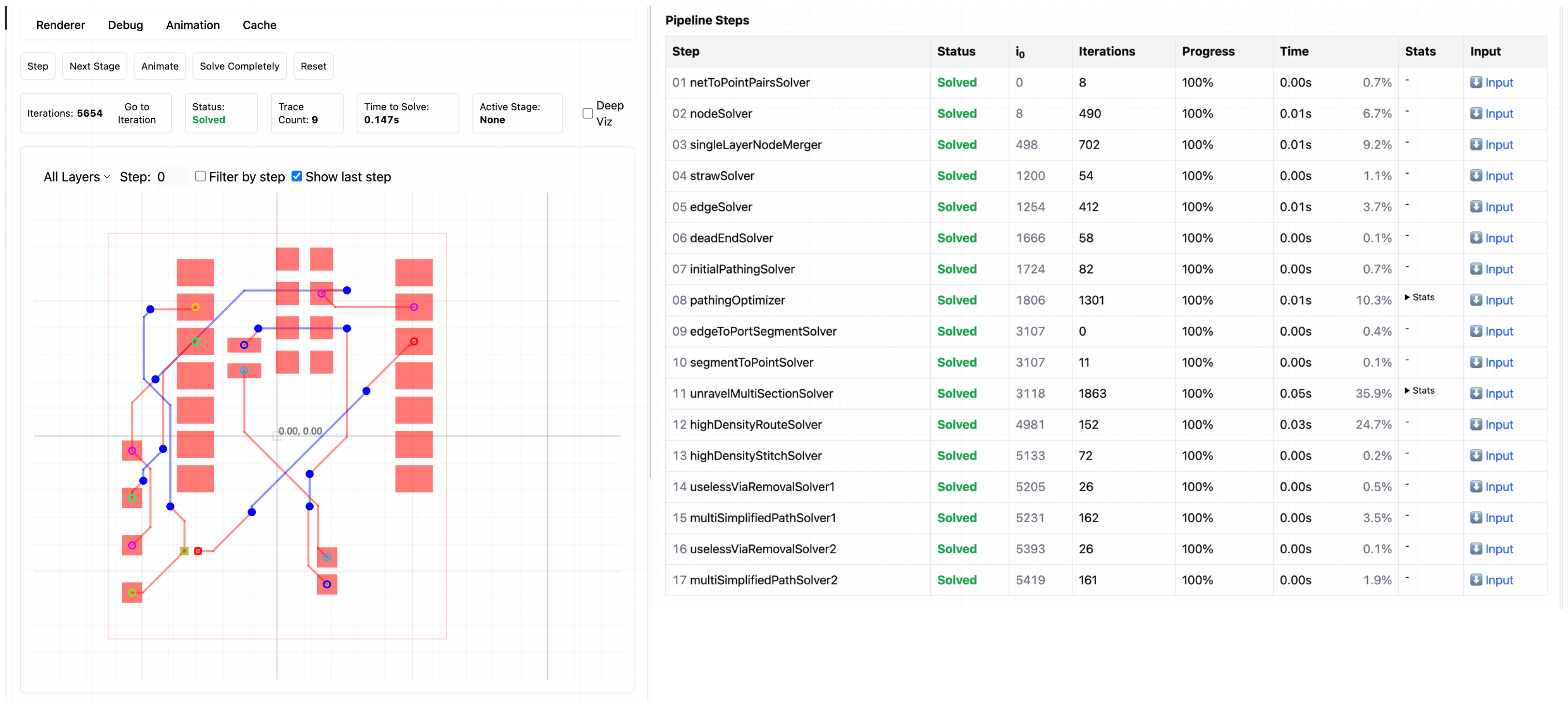

Approximate - Most non-trivial algorithms are hard to implement optimally on the first go. Build your algorithms to tolerate non-optimality, this often means introducing stages just to “improve” the output of prior stages. This is good! For our autorouter, we have stages that “straighten-out” our routes (shown below)

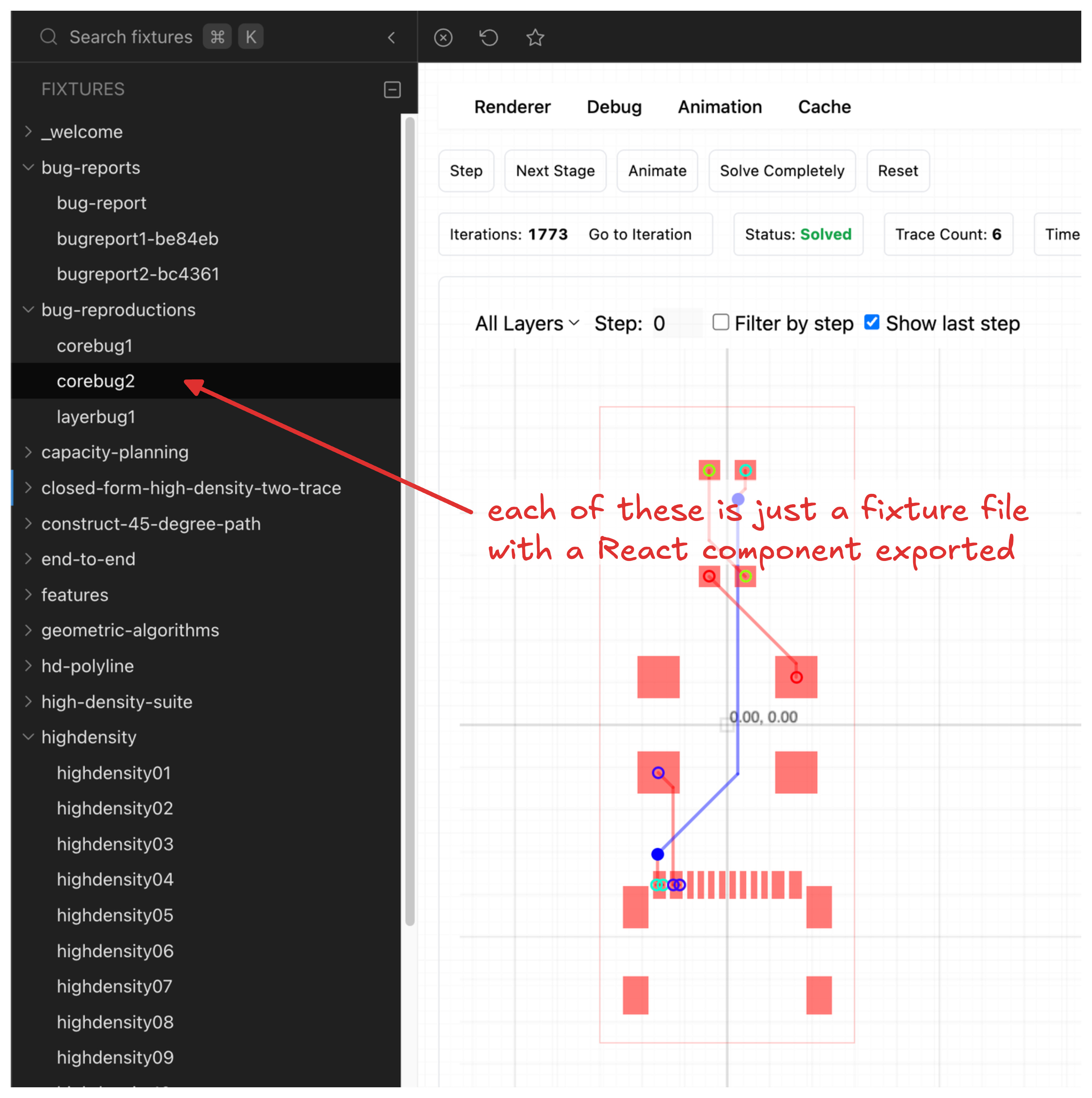

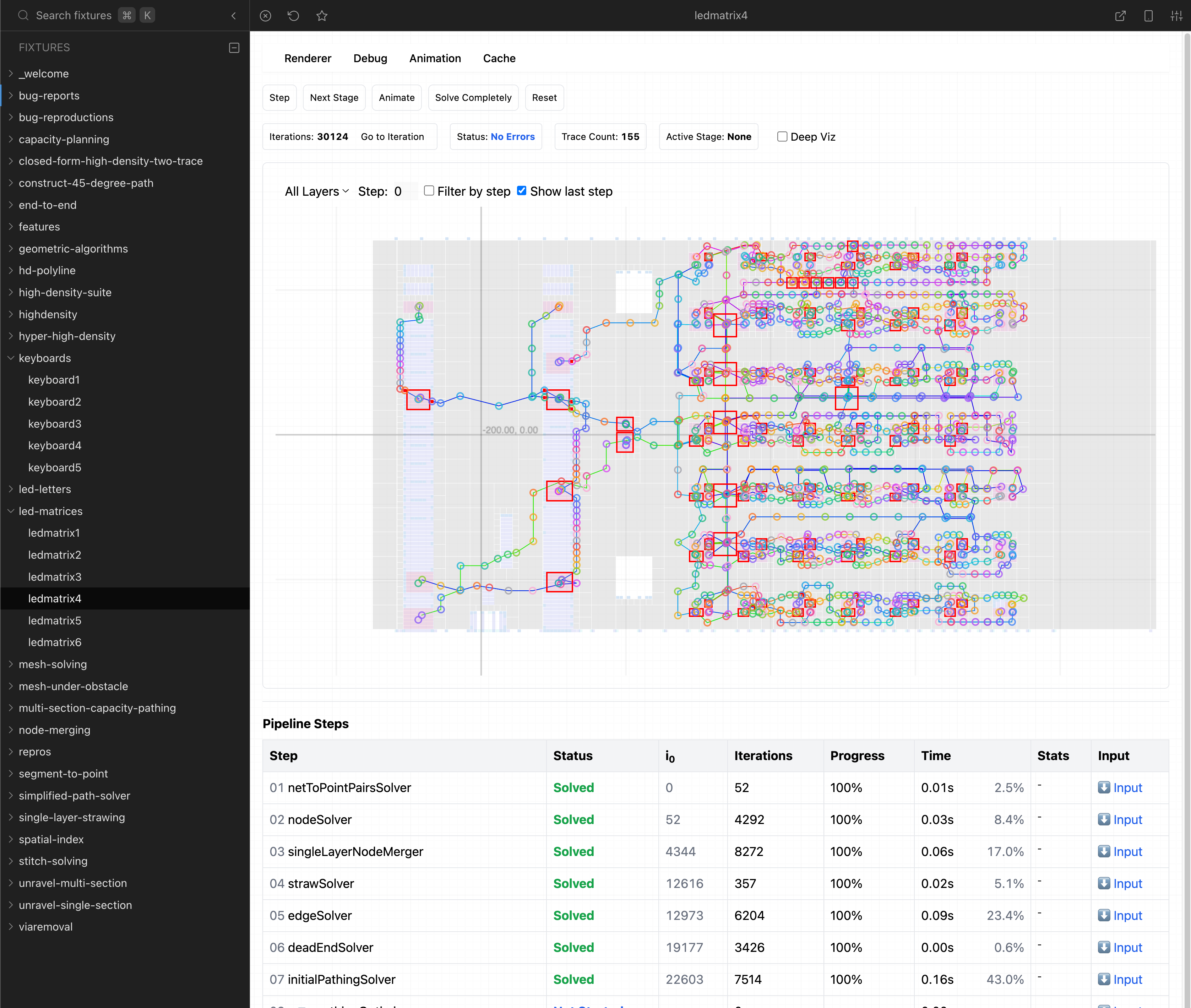

Use React Cosmos for Building Algorithm Web Apps
We use React Cosmos to quickly create web apps for algorithms. We do this because…
It’s nearly zero effort, just create `*.fixture.tsx` files that export a React component and you have a new page (remember, every Graphics Debug object can become interactive with the <InteractiveGraphics /> component from the graphics-debug module!)
Cosmos apps can easily be deployed into preview environments with Vercel
Claude/ChatGPT algorithm React algorithm visualizations can generally just be downloaded and given the extension .fixture.tsx and they’ll work perfectly!

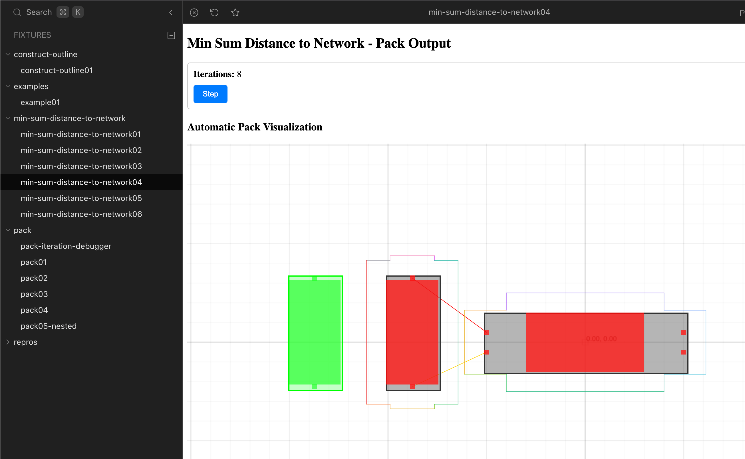

The Progression of an Algorithm Web App

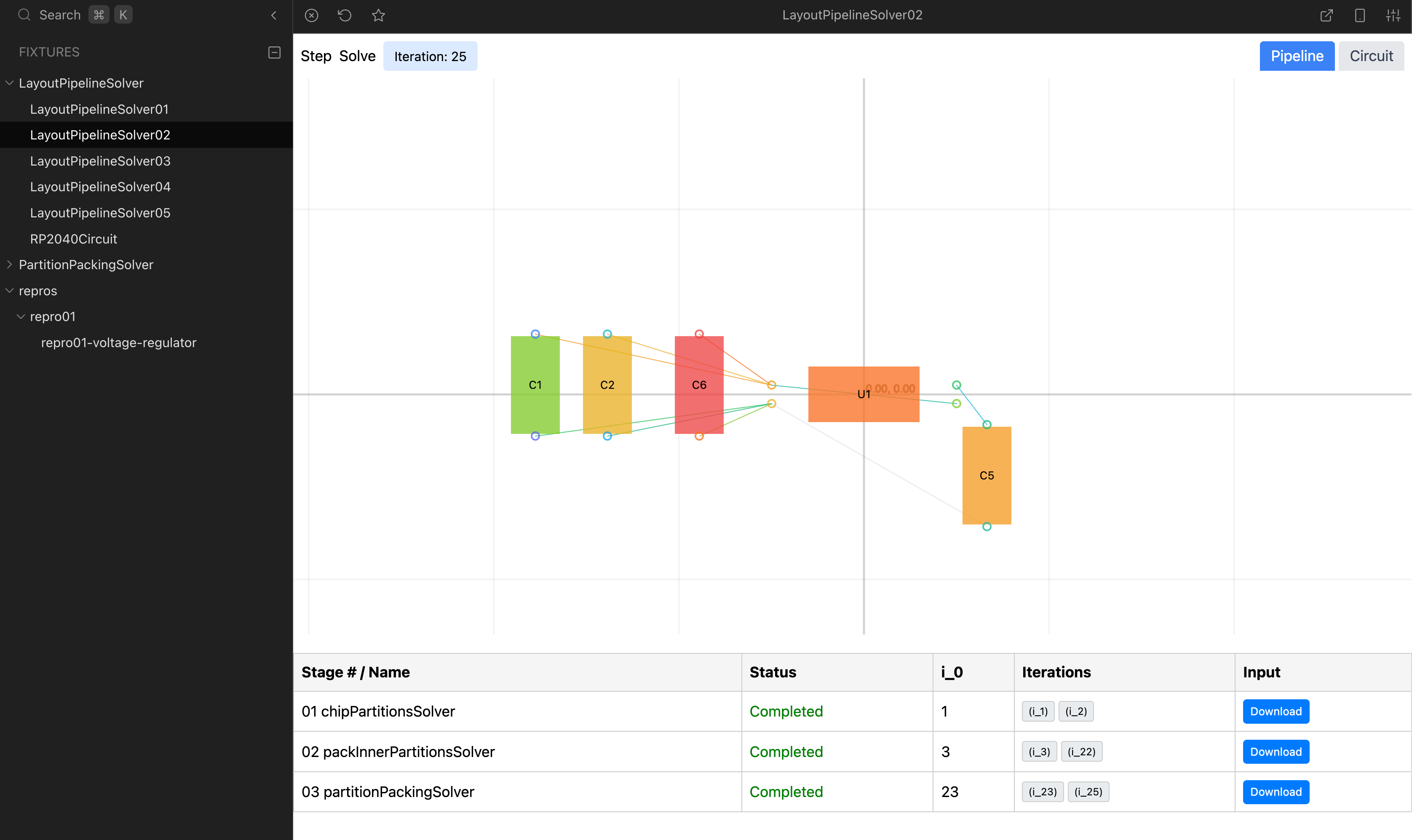

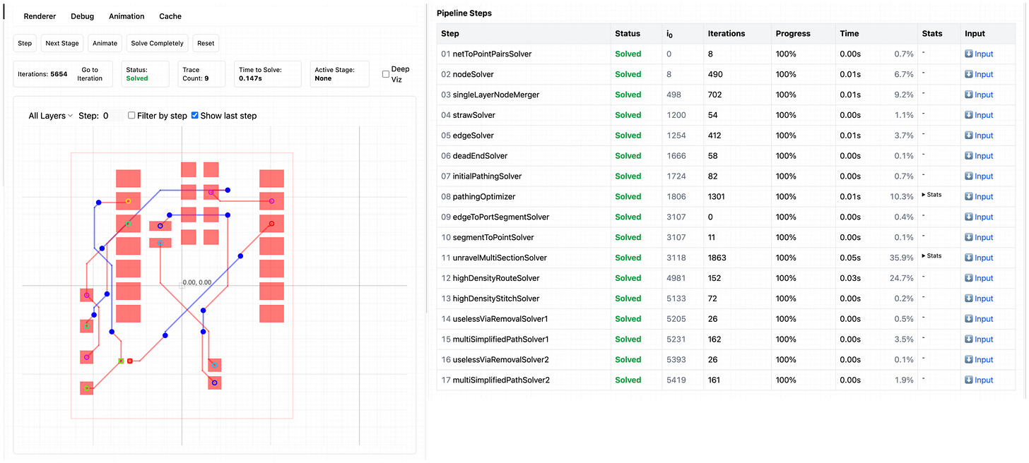

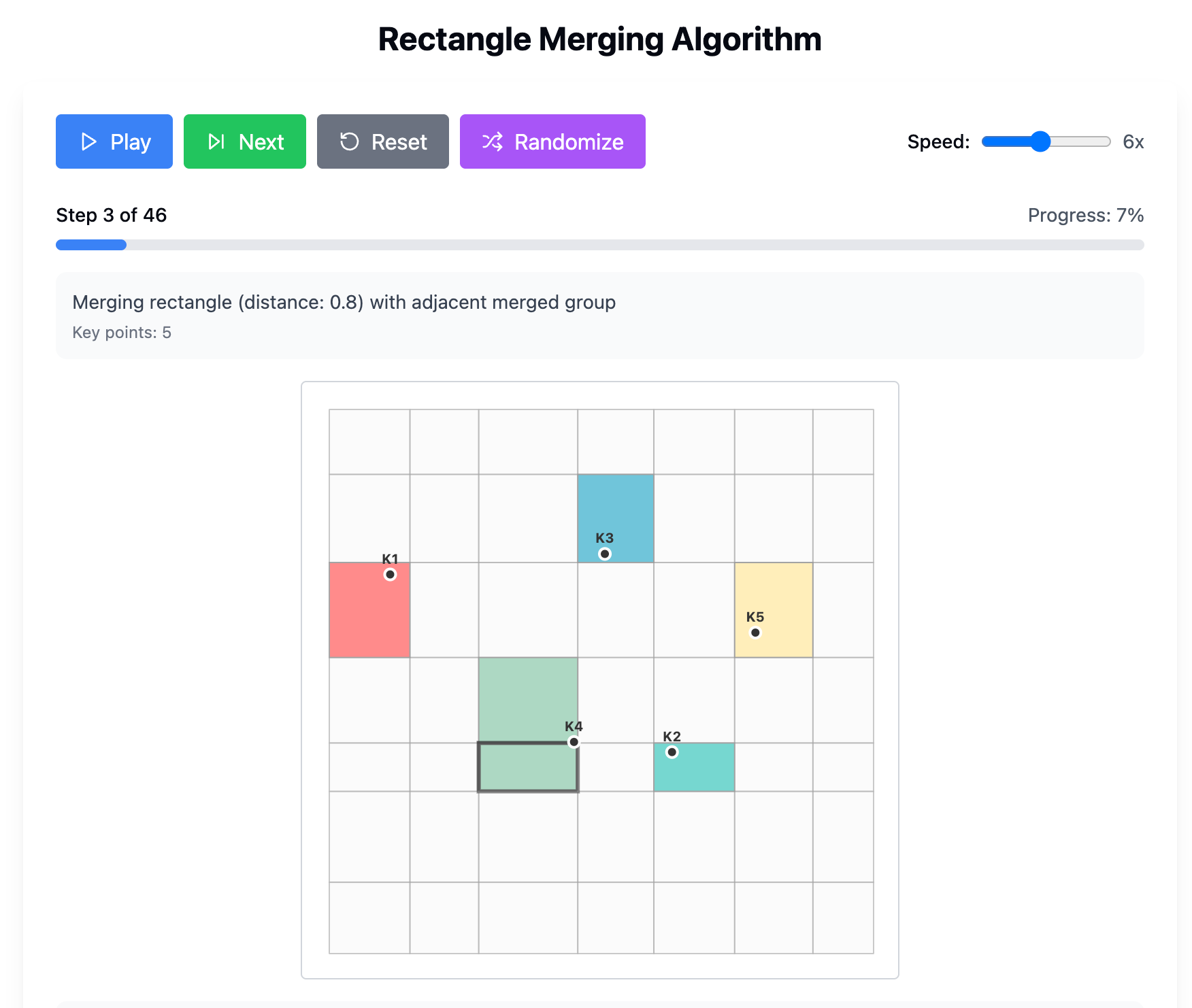

The web app for an algorithm usually sucks at first, only exposing the most basic operations: the visualization and the step function. Over time, you add additional debugging and visualizations to help with understanding. Here are three algorithms in different stages of development:

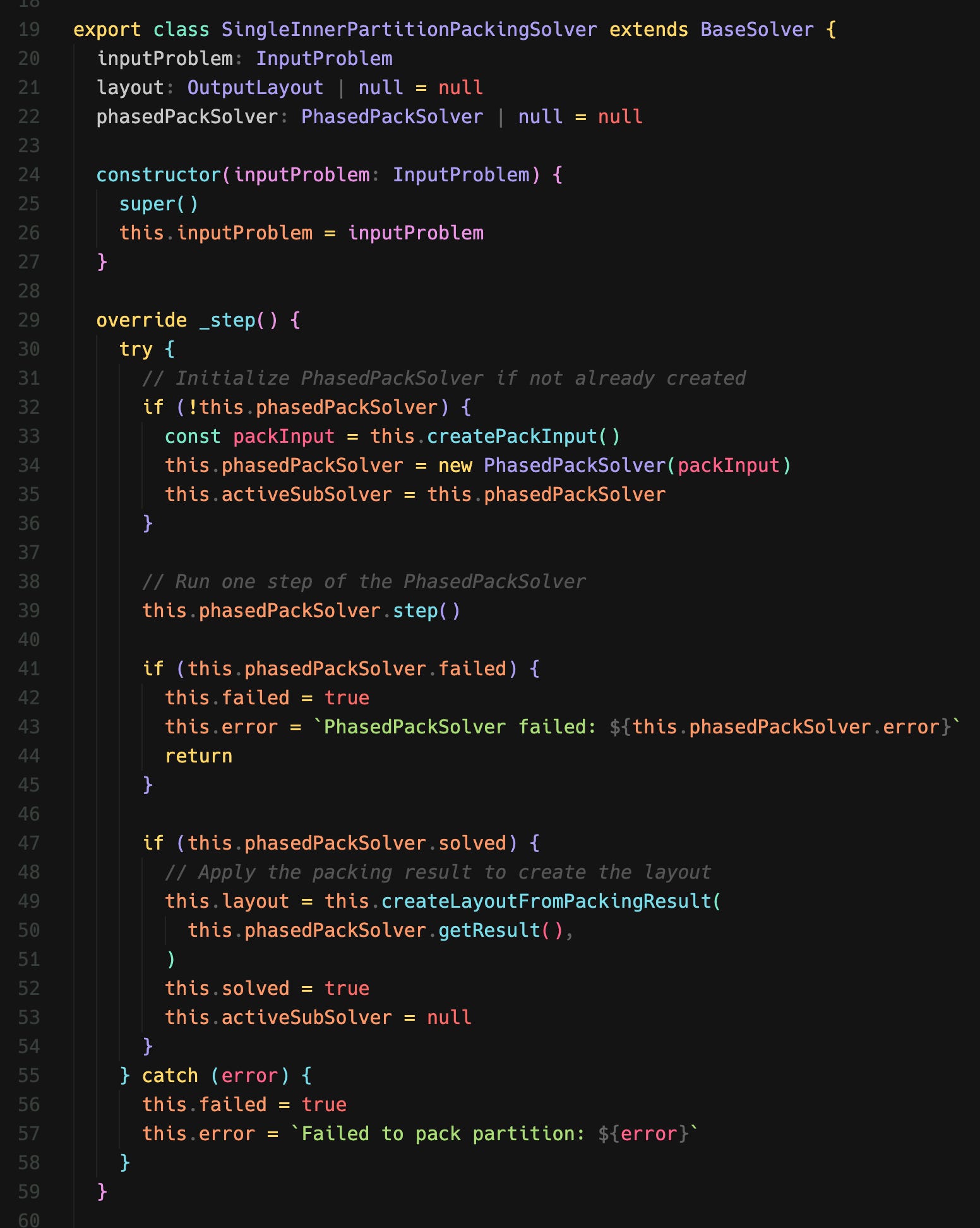

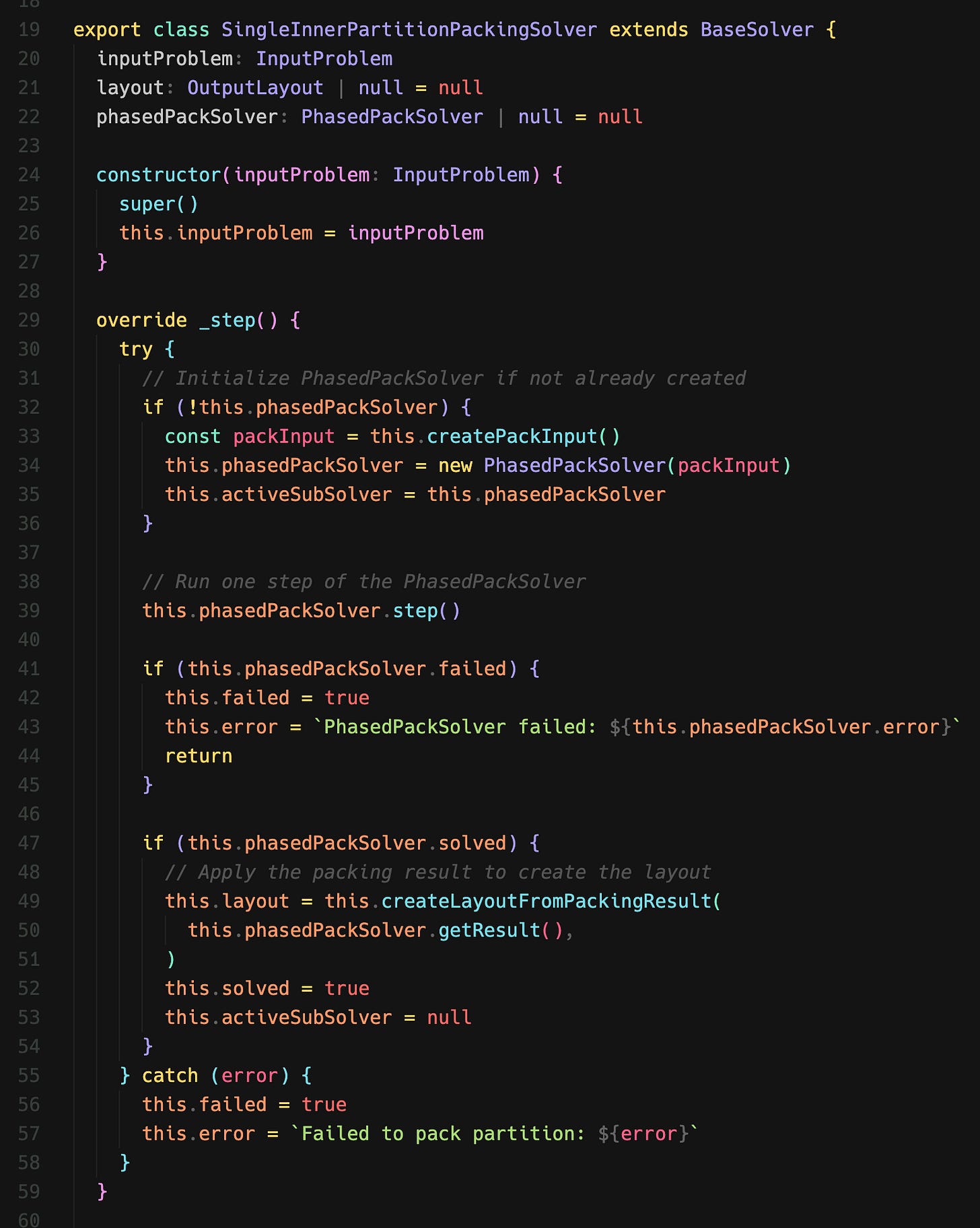

In tscircuit code, “Solver” always means a class with the following methods:
`step()` - Iterate the algorithm just once
`solve()` - Step until the algorithm has been solved or fails
`visualize()` - Get a graphics-debug object for the current iteration that can be converted to an SVG or given as a prop to <InteractiveGraphics />
`.solved` / `.failed` / `.iterations` to track the algorithms progress
This is all you need to build any algorithm! This is a tried and true pattern that has allowed me to build massive algorithms! Don’t skip the visualize(), and don’t have single-step solvers (always iterate and write good visualizations for each iteration). Everything is 100x easier when you use this pattern!
Nesting Algorithms without breaking the rules

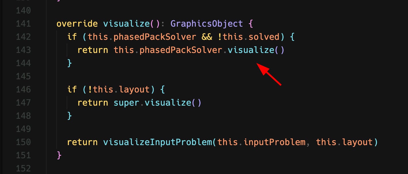

You will NEED to nest algorithms. This is critical for orchestrating a large algorithm. Sometimes when you’re iterating, you’re just calling the `.step()` function of a subsolver! Often your `visualize()` function will just be returning the result of a sub-solver, and that’s totally ok!

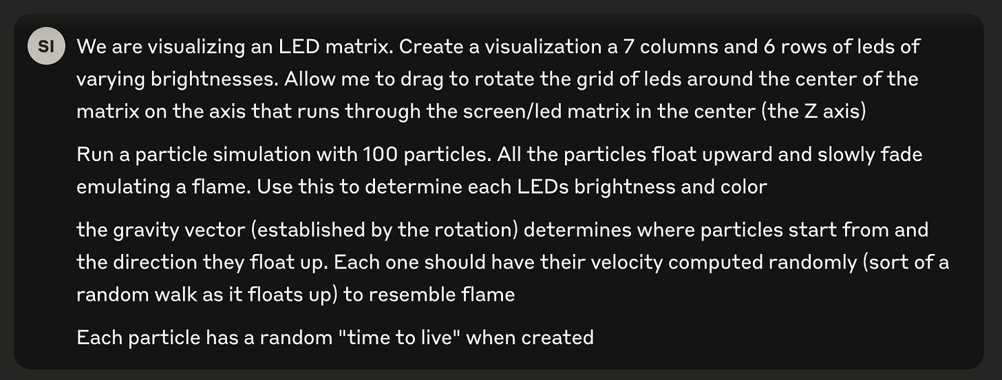

Use Claude.ai for Prototyping, then Claude Code to integrate

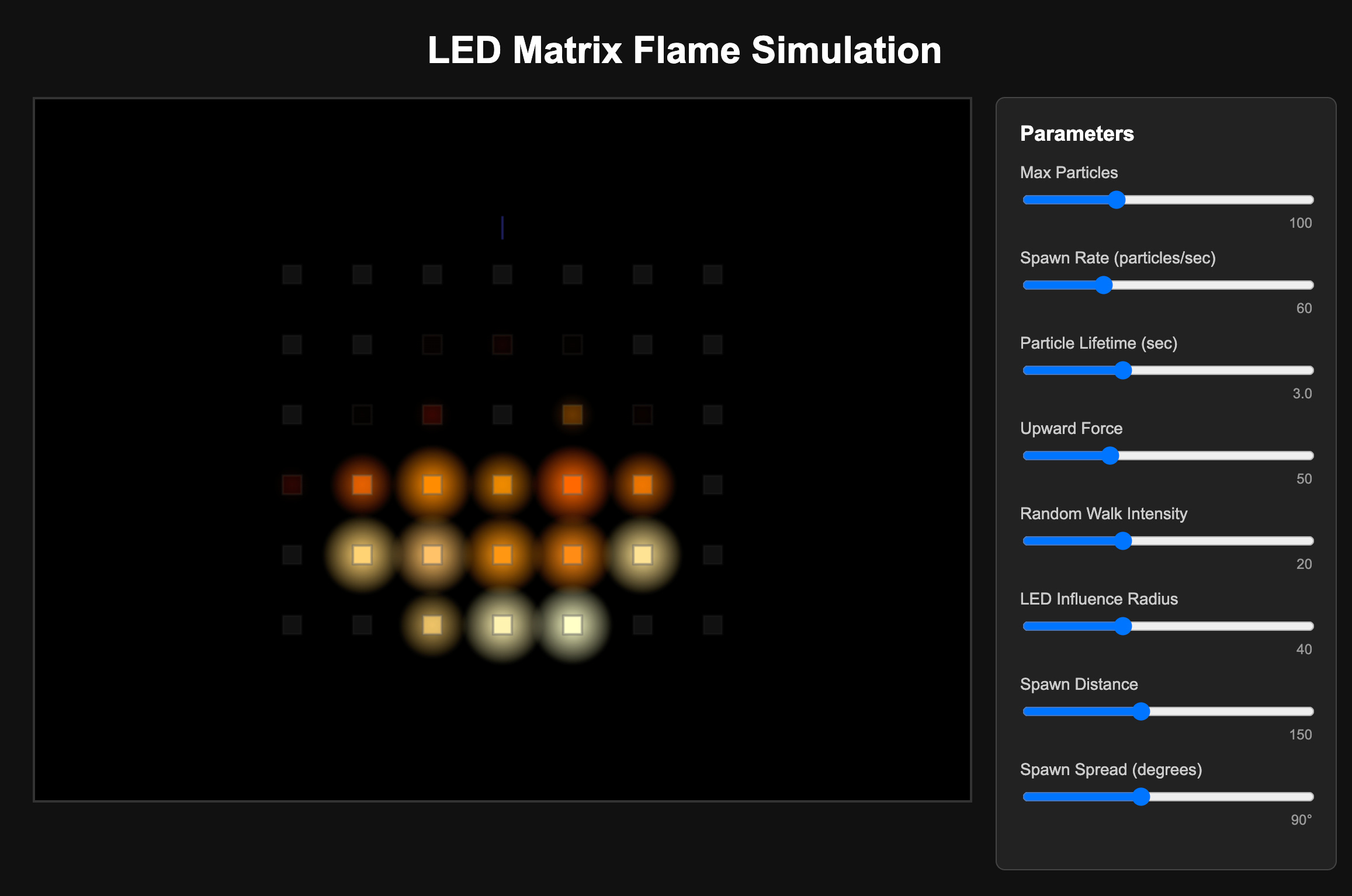

Claude.ai (the website chat for Claude) is fantastic for creating quick visualizations and implementation prototypes of sub-algorithms. You can then copy these visualizations into a fixture file and ask Claude Code to integrate into your codebase. This allows you to build up the algorithm bit-by-bit!

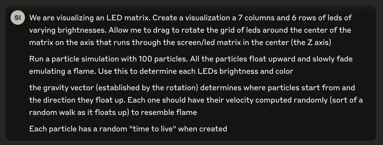

Another prototype built with Claude.ai, this time I passed in the types of the objects from the project so that the algorithm would have some extra understanding of the input problem and output something that was easier for Claude Code to integrate.
